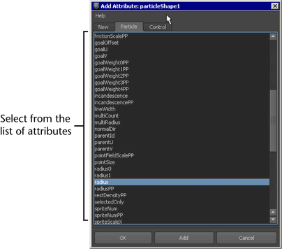

To selectively add a dynamic attribute to a nParticle object
- Select the nParticle object.
- In the Add Dynamics Attributes section of the Attribute Editor, click the General button.
The Add Attribute window is displayed.
- In the Add Attribute window, select the Particle tab.
- Select an attribute.
- Click Add to add an attribute.
- Click OK when you are done adding attributes.
