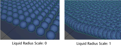

Liquid Simulation section, set
Liquid Radius Scale.
Along with Radius, this sets the amount that nParticles overlap.
nParticle overlap is also affected by nParticle Radius.

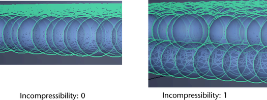

- Set
Incompressibility to specify the amount you want the liquid to resist compression.
See Incompressibility.
