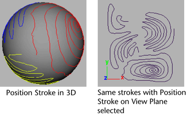

Position Stroke
This option is only useful on strokes painted on objects. It has no effect on strokes painted on the view plane or grid plane of the perspective view. You can use it to create textures from strokes painted on 3D objects (for details, see Create textures from painted 3D objects). Select one of the following:
- in 3D
Displays the stroke on the surface, as painted.
- on View Plane
Displays the stroke between 0 and 1 in world space on the XY plane (near the origin). Think of this space as a texture map—each point on the texture corresponds, or maps, to a point on the paintable surface. Any strokes on the surface are drawn in this area. However, when you do a post-process render, the strokes render on the view plane.

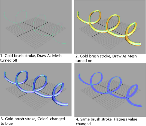

- Draw As Mesh
With the Draw As Mesh option, you can preview the rendered look of your strokes interactively in the scene view; you don't have to view them in the Paint Effects panel. With Draw As Mesh turned on, you can see the Paint Effects strokes in the scene very close to what they will be when rendered. You can tumble around and see what they look like from any camera view, and you can model on other objects in the context of the Paint Effects in the scene. If you want to do any modeling on the stroke objects, you need to convert them from Paint Effects to polygons. One of the biggest benefits of working with Draw As Mesh turned on is that you can edit brush attributes and see the changes happening to the stroke (Paint Effects shape) in the scene view.
The drawing of Paint Effects strokes in the scene view is much faster than the stamp draw in the Paint Effects panel. You can draw all Paint Effects as polygons in three ways:
- Select Display > Rendering > Paint Effects Mesh Display (see Rendering Options).
- Select strokes and turn on Draw As Mesh in the strokeShape Attribute Editor.
- Select Draw As Mesh in the Paint Effects Tool Options ().
Notes:
- When Draw As Mesh is turned on, it may be somewhat slower than line draw, particularly during playback when the brush or painted object has animation.To speed up playback, either turn off Draw As Mesh or decrease the Display Quality, which has no effect on the rendered output.
- Using Draw As Mesh with Paint Effects Hair does not provide more useful information and may in fact be slower. The line draw is as good or better for Hair.

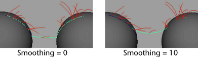

- Smoothing
The path of a stroke is defined by an underlying stroke path curve which is comprised of CVs. Just like using the Pencil Curve Tool, painting a stroke can create irrelevant CVs. Use this option to dampen the effects on the stroke path curve of spurious or misplaced CVs by recalculating the smoothest path through the CVs.
Specify the amount of smoothing to be calculated. A Smoothness setting of 0 causes no smoothing.
You can also use smoothing to soften the transition between multiple surfaces.
Note: Although smoothing does not alter the number of CVs, you can also smooth strokes by removing CVs. For information, see Simplify stroke path curves. - Motion Blurred

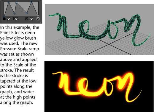

- Pressure Scale
Use this graph to edit the line width along a stroke (as well as other pressure controlled attributes). This is great for tapering strokes and getting a “sketching” look.
