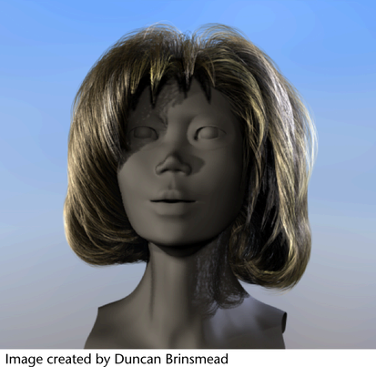

Self shadowing is particularly important for natural looking hair. Shadowing for long hair, if using Paint Effects hair, has the same issues as shadowing with regular Paint Effects. Depth map shadows must be used since raytraced shadows are not supported. Also you must turn off Use Mid Dist. The Bias generally needs to be adjusted when Use Mid Dist is off; increasing the Bias will allow more translucent penetration of the light into the hair, as well as avoid noisy grid self shadow artifacts on surfaces. nHair is very thin and you need to use fairly high resolution shadow maps. However, increasing the Filter Size can help smooth the shadows which helps simulate the diffusion of light scattering through the hair. It can also soften chatter and aliasing of the hair shadow. (For more information about light and shadow attributes, see Shadow attributes and Shadow in Maya.)
In terms of Bias you should generally start with a low value, then increase it until surfaces no longer have self shadow artifacts (dark fringes on the surface). You might then further increase this value to allow for more light penetration into the hair. In general the higher the Filter Size, the larger the Bias should be. For very soft translucent hair, you should use a relatively high filter size and large Bias. Sometimes you can get similar effects with lower filter sizes combined with lowering the depth map resolution, although the filter size should not go below 2.
