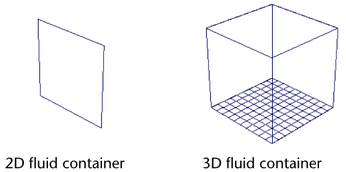

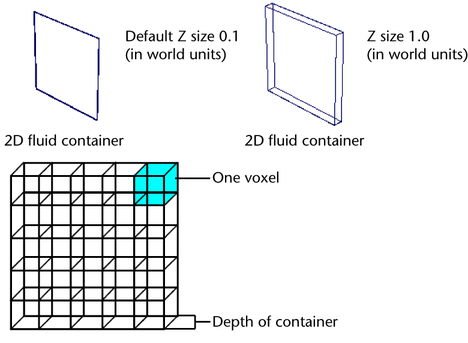

2D containers
A 2D fluid container is a 3D fluid container with a depth of one voxel. The size of that voxel is determined by the Z size of the container.
As the Z size gets bigger, any Density in it becomes more opaque. By animating the Z size you can mimic the 3D effect of an object moving through the fluid without the extra rendering time it would take to have a full-fledged 3D fluid.

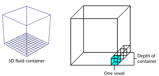

3D containers
A 3D fluid container is a fluid container with a depth of two or more voxels.

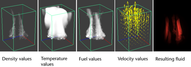

Example
This example combines Density, Temperature, Fuel, and Velocity values to create a dynamic simulation of a flame.
