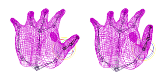

Influence objects can deform smooth skin objects by influencing the position (translation) attributes of their skin points. To explore an example of creating muscle bulge in a hand using an influence object, see Skinning a hand.

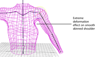

Using influence objects to prevent unwanted deformation
An important use of influence objects is to prevent unwanted deformations from occurring. After smooth skinning, you may find that certain areas deform more than you would like. For example, deformations around a shoulder may be too extreme when you rotate the shoulder joint.

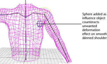

You can prevent such unwanted effects by adding an influence object whose influence counteracts the influence of other deformations. For example, you can add an influence object near the shoulder area that counteracts any extreme effects resulting from smooth skinning.
Note that you can use a NURBS or polygonal object of any shape. In this example, you might want to edit the sphere’s shape for more precise control over the final deformation around the shoulder.
