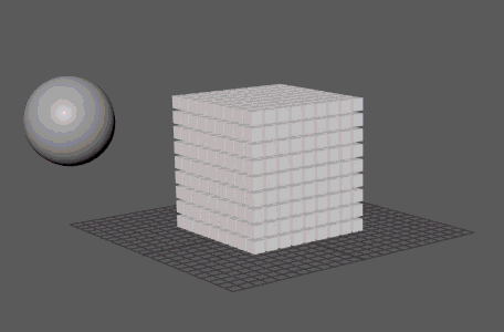

Applies dynamic forces (using
Bullet) to the MASH network including (but not limited to) gravity, friction, collision. You can interact with the simulation in realtime by adjusting its attributes during playback.
Note: To collide with objects outside the MASH network, those objects must be added to the
BulletSolver node's
External Colliders list.
Note: Avoid adding animated objects (i.e. deforming) to dynamic MASH networks. MASH will only consider their starting position / shape as the collision shape, meaning collisions after frame 1 will appear incorrect.
