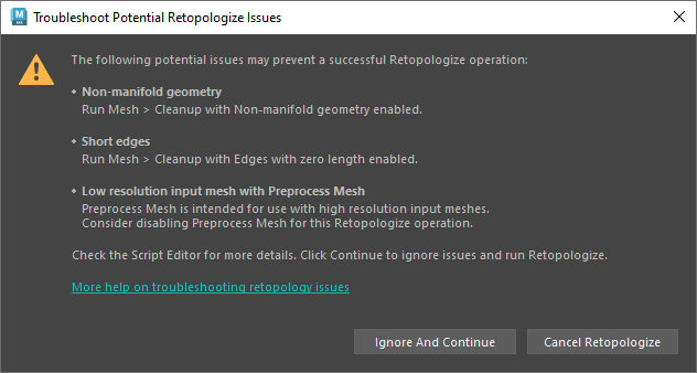

When
Scan for issues is turned on in the Retopologize Options (Mesh > Retopologize >
), your input mesh is checked for potential issues that could either prevent
Retopologize from running successfully or have adverse effects on the result. If issues are detected, the
Troubleshoot Potential Retopologize Issues dialog box appears with warnings and recommended troubleshooting steps:
The following table further explains each warning and suggests possible solutions.

Tip: These warnings provide general information; however, additional information is available in the
Script Editor for certain warnings. For example, if your input mesh has problematic edges and/or faces, text similar to the following example is printed in the
Script Editor:
// The selected mesh contains 3 edge(s) with a length less than 0.0001: // mesh.e[25582] mesh.e[51685] mesh.e[75851]
