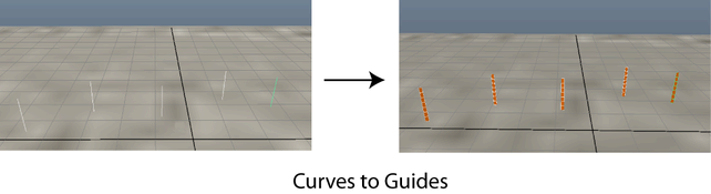

Curves To Guides options
Converts curves back to guides so you can continue to shape and edit them. You can use Guides to Curves after editing the Guides.
