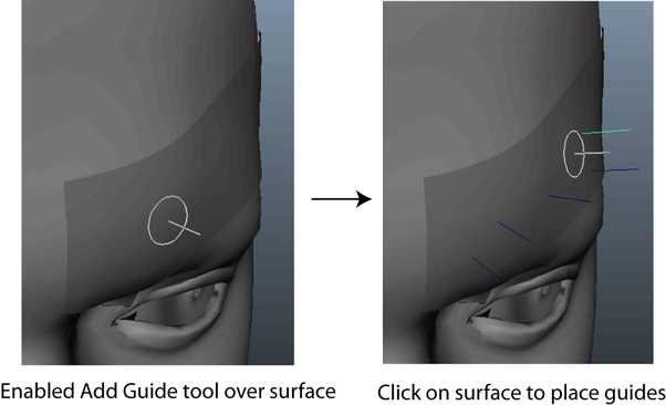

Add guides to your mesh object
Use the Add or Move Guides tool to place guides on the surface your mesh object. You can use guides to position and shape all primitive types, including archive geometry.
To add guides to your mesh object
  1. With your guides-based Description selected in the XGen Editor, select the Add or Move Guides tool:.
    When you hover the cursor over the selected surface, a circle icon appears, indicating that you can add guides to the mesh.
  2. Click the surface to place guides.
    Guides appear on the surface of the selected mesh.
  3. (Optional) To increase or decrease the radius of the Add or Moves Guides tool, press the B key while dragging.
  4. Preview the Description. See Preview hair, fur, and instanced geometry.

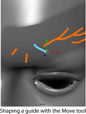

Shape and scale guides by editing guide CVs
You can modify the shape of XGen guides by selecting, and then editing the guide CVs. You can use also Utilities, such as Guides As Curves, Reshape Guide and Straighten Guide, to edit guide shape.
To shape guides by editing CV's
  1. -click the guides you want to shape, and select Guide Control Points from the marking menu that appears.
  2. Maya switches to component-selection mode, which lets you select CVs on the guides.
  3. Use the Move, Rotate, and Scale tools to shape the guide.
    If you have problems getting the shape you want, add control vertices to the guides.
  4. (optional) To add control vertices to the guides, in the XGen Editor, click the Primitives tab.
  5. (optional) In the Primitives Attributes section, click Rebuild and increase the CV Count value in the Rebuild Guides window. See Work with XGen guides.
  6. Return to object-selection mode by -clicking a guide and selecting Object Mode from the marking menu that appears.
