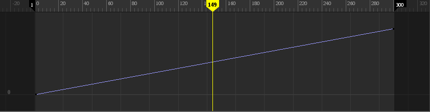

Time Warp
While a Speed Curve changes the playback speed of a clip in a non-linear way, a Time Warp provides frame-to-frame mapping. Whatever you do with the warp curve, it will not modify the length of the clip. If you speed up one part, it will slow down another part because it is frame to frame mapping. To change the speed, stretch or shrink the clip in the Time Editor.
When you look at a Time Warp curve in the Graph Editor, the curve appears as a diaginal line. The horizontal axis of the curve represents output frames of the clip while the vertical axis represents the input frames.
For example, a normal clip will show key 17 playing back at frame 17, which would be linear, but you could create a Time Warp to let you play key 17 at frame 50, creating a speed increase.
See Create and edit Time Warps with the Time Editor.

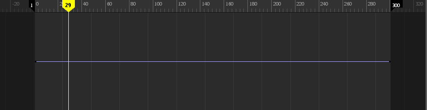

Speed Curve
Speed curves lets you modify the playback speed of different parts of a clip and are found in most editing applications such as Adobe Premiere. Use a speed curve when you want to alter the speed in an area of an animation by setting keys to mark the areas to define the area you want to adjust.
When you look at a Speed Curve in the Graph Editor, the curve shows a straight line, which means the clip has a value of 1 for the duration. The straight line indicates that each frame is played back with speed of 1.
Note: A Speed Curve lets you assign various forward speeds to the animation in a clip. You cannot make the speed curve go backward . The animation in the clip is shorter than the size of the clip when you shorten it with a speed curve.
Changing the speed curve changes the duration of the clip. If you make the clip twice as fast, the clip appears twice as short in the Time Editor.
See Alter clip speed with Speed Curve.
