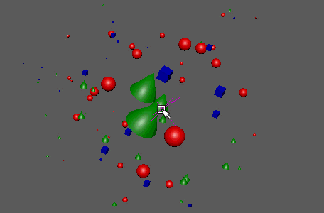

Influences the scale and rotation of object instances according to the scale and rotation of connected influence locators. A starting locator is automatically added to the scene by default.
