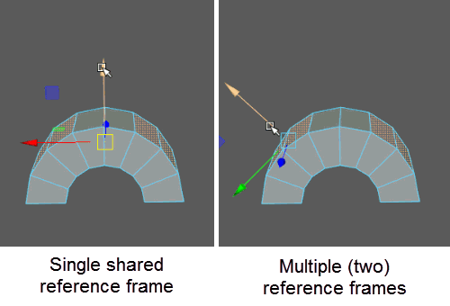

When moving, rotating, or scaling components, you can choose to transform them all relative to a single shared reference point, or along multiple reference frames based on which components are selected.
  • To transform components relative to a single shared reference frame, use the Move, Rotate, or Scale Tool with Axis Orientation set to World or Local. For more information, see Transform Objects and Components.
  • To transform component groups along their local reference frames, use the Move, Rotate, or Scale Tool with Axis Orientation set to Component. For more information, see the section on Component Grouping below.

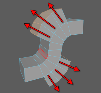

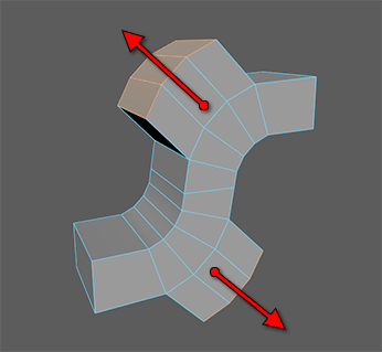

  • To translate each individual component using its own reference frame, Ctrl + middle-drag while using the Move Tool.

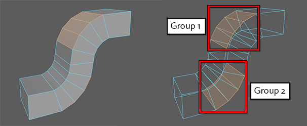

Component grouping

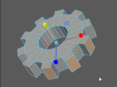

Component groups refer to any sets of adjacent components within the current selection.
Setting Axis Orientation to Component transforms each group according to its own reference frame. The reference frame for each group is the average of all components within that group.
However, one exception is when Ctrl + middle-dragging with the Move Tool. This translates each component along its own reference frame, ignoring their group.

While using the Move, Rotate, or Scale Tool, you can temporarily activate Component mode by Ctrl + middle-dragging. This works with any Axis Orientation currently active, except Normal, and will constrain the movement differently depending on which tool is active.
Operation Effect:
Ctrl + middle-dragging with the Move Tool moves each component along its own normal (ignoring component groups).

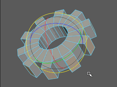

Ctrl + middle-dragging with the Rotate Tool rotates each component group along its local X axis.

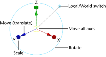

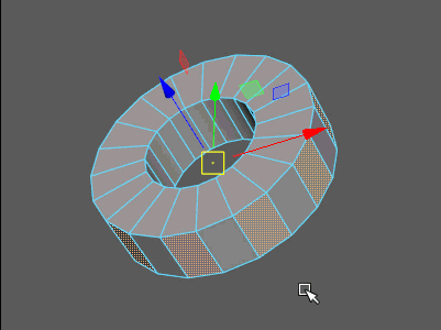

  3. Drag the manipulator handles to move, rotate, or scale the components, or change the settings in the Attribute Editor or the Channel Box.

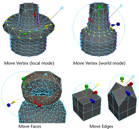

    The manipulator is a standard move/rotate/scale combined manipulator, with an extra handle to switch between Local axes and World axes. Moving components along their local Y can be very useful to move components “inward” or “outward”.
