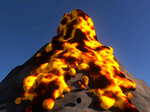

Using Liquid Simulation attributes, you can add properties to your nParticle objects to make them look and behave like flowing liquids. Liquid Simulation attributes let you to create simulations, ranging from slow moving lava, mud splatters, droplets of liquids, and splashes of water. See Create nParticle liquids.
