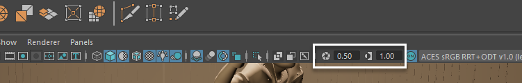

Setting Gamma and Exposure levels for a Playblast
Gamma and Exposure settings in the Panel Toolbar
The Gamma and Exposure settings in the Panel Toolbar affect your Playblast output. Exposure lets you adjust the brightness for the scene and Gamma adjusts the contrast.
