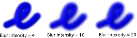

Blur Intensity
This option is available only when Brush Type is set to Blur. It defines the blurring effect of the brush.
