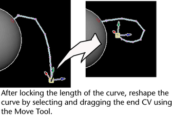

You can lock curve length and reshape the curve(s) by selecting and moving the end CV(s). In addition to locking length, you can reshape curves using other items in the Modify Curves menu, including Straighten, Smooth, Curl, Bend, and Scale Curvature.
These same tools are available for editing NURBS curves. For descriptions on NURBS curves editing, see Curves menu.
To use Lock Length while editing curves
- Switch to Start or Rest Position ()
- Select the curve(s) and then convert the selection to end CVs (see nHair menu).
- Press the l (letter) key to turn Lock Length on while editing curves.
- Release the l (letter) key to turn Lock Length off.
