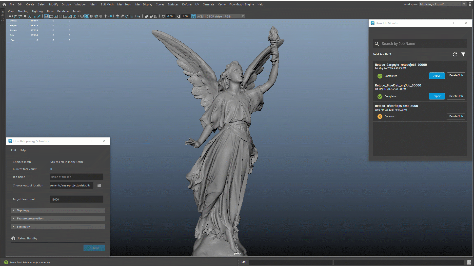

Flow Retopology works just like Maya's Retopologize tool, simplifying complex geometry, making it easier to work with. Flow Retopology leverages remote cloud computing to process mesh operations, letting you continue to work in Maya while the job completes.

The main difference between Flow Retopology and Maya's Retopologize tool lies in the processing. Maya's Retopologize tool can be computationally heavy, causing Maya to freeze until the process is complete. Flow Retopology, however, offloads the computation to a remote job monitor, freeing up system resources and letting you continue your work.
With Flow Retopology, you can run several retopologize operations simultaneously, even on a single mesh with distinct settings for each operation. This parallel processing, separate from your work in Maya, saves time and increases efficiency.

Flow Retopology includes a Job Monitor notification system for tracking jobs. Once a job is finished, the result is saved to disk. You can then import this result back into Maya from the Job Monitor.
