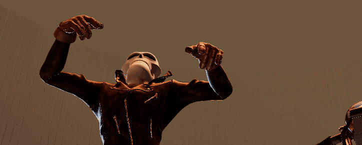

Ghosting animated objects
Ghosting, also known as Onion Skinning, simulates a technique in animation where an animator flips through a sequence of drawings to get a feel for the timing of the action. Ghosting lets you visualize the flow of a character’s motion, so you can troubleshoot and make decisions about the motion timing.
Ghosting in Maya ( or ), lets you display an animated object for specified frames before and after the current frame. Ghosts refer to character images displayed at a time other than the current one. Ghosting can be controlled locally on each object in your scene, and you can ghost entire skeletons, object hierarchies, or specific parts of an object.
You cannot ghost animation that is based on expressions or simulations, such as Dynamics, Maya® nCloth™ or Maya® Classic Cloth™ animations.
You can control how ghosts look in the scene view, setting the color of ghosts before and after the current frame, and the number that are displayed. See Ghost an object for more information.

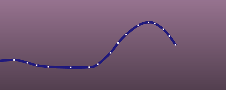

Motion Trails
With Motion Trails, you can display and edit the trajectory of an object. Motion Trails work with objects that are animated by keyframe animation, deformers, motion capture, and expressions. You can create the Motion Trails before you animate an object or after. See Motion trails and Create and edit a Motion Trail.
