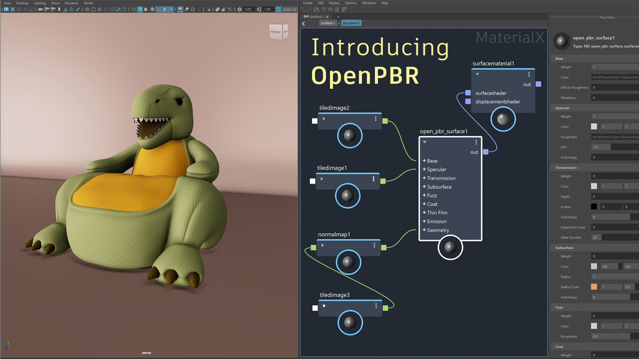

The latest update to LookdevX introduces OpenPBR, an open-source shading model that offers enhanced functionality, usability and software interoperability.
What's New in LookdevX for Maya 1.6.0
- OpenPBR
OpenPBR is now available in LookdevX. An open-source shading model jointly developed by Autodesk and Adobe, OpenPBR is designed as the successor to Autodesk Standard Surface and Adobe Standard Material, offering enhanced functionality, usability and software interoperability. You can find OpenPBR materials under the new OpenPBR category in the Tab menu or Node Library.
