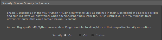

General Security Preferences
- Security
- The
General Security Preferences control all the security settings in the window.
Turn on the security settings using the General Security Preferences options
- Select On to turn on all security preferences (MEL, Python, Plug-ins) at the same time.
- Choose Off to disable the security settings, which may be necessary if Maya is blocking a file from loading. (In this case, see the sections about Flagged commands/scripts in this topic.)
- Select Custom if you want to change any of the default settings. Maya automatically switches this setting to Custom when you activate/deactivate any of the subsections in the Startup Script Permissions.
