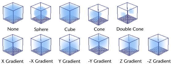

- Dropoff Shape
Defines a shape to use to define an outer boundary for creating a soft edged fluid.
Setting Dropoff Shape to Use Falloff Grid lets you can define an arbitrary falloff region. When Use Falloff Grid is selected for emitted fluids, the fluid does not appear in the volume. See Define an arbitrary falloff region for fluid containers.

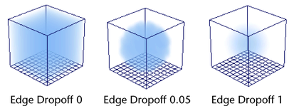

- Edge Dropoff
Defines the rate at which the Density values drop off towards the edges defined by the Dropoff Shape. A value of 0.0 results in no dropoff. As the value increases, the Density fades smoothly from the center to the edge of the dropoff shape.

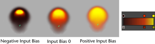

- Input Bias
Color Input Bias adjusts the sensitivity of the selected Color Input. Input values of 0 and 1 always map to the start and end of the ramp, while the bias determines where in the ramp a value of 0.5 maps. If the Input Bias is 0.0 then a Color Input value of 0.5 maps to the exact middle of the color ramp. Instead of values that are very close using the color at one part of the ramp, you can use the full range of colors to represent the values.
For example, if Density is the Color Input and the Density values in the container are all close to 0.1, you can use the Input Bias to shift the ramp color range so the Density values around 0.1 can be differentiated using the full range of colors on the ramp. If you do not change the Input Bias, the differences in color for values close to 0.1 could be indistinguishable.
