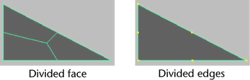

You can subdivide a polygon face into triangles or quadrangles. Divisions are added either exponentially or linearly. To understand the difference, see Smooth Options.
Note: You can also use
Add Divisions to divide polygon edges. For more information see
Divide polygon edges.

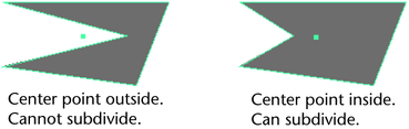

- A face does not subdivide
You cannot use the Add Divisions feature on faces that contain holes. Also, you cannot subdivide concave faces unless the center point is inside the face.
To subdivide a concave face into convex parts, use the Multi-Cut Tool or Mesh > Triangulate. To remove holes use Triangulate.
