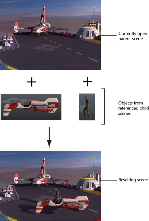

Assemble multiple objects, such as modeled polygons, shading materials, and animated characters, without importing the files or objects into a scene. The contents of referenced files appear in the scene, but the data for the objects is read or referenced from pre-existing files that remain separate and unopened.
File referencing lets you use Maya objects and scenes in collaborative production situations where multiple users need to work concurrently and share various scene assets in complex scenes.
A scene file that references other files is known as a parent scene to indicate its position within the file referencing hierarchy. A parent scene reads or references other files called child scenes. Even though the referenced child scenes appear in the parent scene, the child scene data remain separate from the parent scene at all times.
A reference node is created for each child scene when it is referenced into a parent scene. The Outliner displays reference nodes with an
