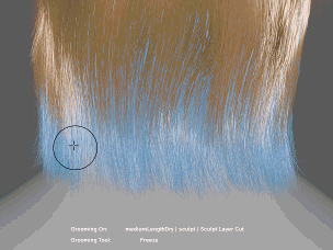

Brush Mode: Global
Local

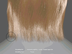

Freezes CVs in the brush radius. Use this option to freeze CVs in specific areas. This is the default setting.
Brush Mode: Local

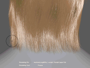

Smooth
Applies a smoothing effect to the freeze values. It does not affect the position or orientation of the hairs or CVs.
Use this option if you want the freeze effect to transition evenly between the CVs in areas you have already frozen by painting.
Operation: Smooth
