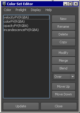

  2. From the Modeling menu set, select Mesh Display > Color Set Editor.
    The Color Set Editor appears listing the per-vertex color set generated from your fluid object.
  3. In the Color Set Editor, select the per-vertex color set you want to use as the polygon objects current color set.
    For example, if you want to color the fluid output mesh using the per-vertex data derived from the fluid object’s Incandescence ramp, select incandescencePV(RGBA).
    If your fluid object’s data does not appear in the Color Set Editor, click Update.
  4. Click Update.

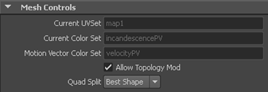

  5. In the Attribute Editor, click the polySurfaceShape tab.
  6. In the Mesh Component Display section, turn on Display Colors.
    Your fluid output mesh should now display the colors defined by the selected color set. In the Mesh Control section, the Current Color Set attribute should be set the selected per-vertex data set.
