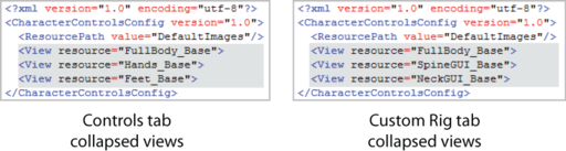

You can customize the HumanIK window Controls and Custom Rig tabs by editing the CharacterControls.xml file in a basic text editor such as Notepad or Programmer's Notepad. You can also edit the look of the HumanIK tabs to accommodate your workflow or animation rig by changing the layout.
The CharacterControls XML configuration files is in the CharacterControls directory (C:\Program Files\Autodesk\<Maya version>\resources\CharacterControls). See Edit the HumanIK Character Controls layout for a description of the areas you can customize.

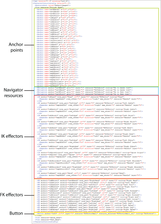

The following diagram shows the Full Body view in the CharacterControlsConfig.xml file and highlights its main areas and elements.
Main Elements
Each section in the configuration file uses the following resource elements, for example, <View resource="FullBody">: for resources specific to the Full Body, <View resource="LeftHand"> for resources specific to the left hand, <View resource="RightFoot">, for resources specific to the right foot, and so on.
If you want to use images stored in a different location than the default, you need to modify the corresponding resource element so it points to right folder. See
| Element | Description |
| <ResourcePath> |
Identifies the directory that contains the image resources. |
| <View resource> |
Encloses all of the elements for the view and identifies the background image. |

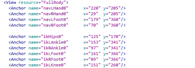

Anchor points
The configuration file is built upon the concept of anchor points, 2D x and y coordinates that are used to define the location of other elements in the layout. Anchor points are linked to other elements. As a result, the anchor point coordinates determine the location of these elements about the layout.
You can attach a navigator resource or an IK effector to an anchor point.
| Attribute | Description |
| <anchor> |
Identifies the anchor point that defines the Navigator resource location. |
| <x> |
The x coordinate for the anchor point. |
| <y> |
The y coordinate for the anchor point. |

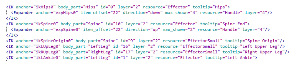

IK effectors
| <anchor> |
Identifies the anchor point that defines the location of the IK effector. |
| <body_part> |
Identifies the body part keying group for the IK effector. For example, LeftLeg, RightLeg, RightArm, or LeftArm. See Manipulation and keying modes. |
| <id> |
The internal ID for the IK effector. |
| <layer> |
This number corresponds to the layer that is assigned to the IK effector. |
| <resource> |
The name of the image that is used for the IK effector. |
| <tooltip> |
Annotation text for the IK effector. This text displays when you hover over the IK effector in the layout. |
| <anchor> |
Identifies the anchor point that defines the location of the effector handle. |
| <item_offset> |
This number represents the offset between the extra effector handle and the first extra effector, in pixels. |
| <direction> |
Indicates the direction in which the handle expands: up, down, right, or left. |
| <max_shown> |
Sets the maximum number of extra effectors that can be added to the expander handle. |
| <resource> |
The name of the image that is used for the effector handle. |
| <layer> |
This number corresponds to the layer assigned to the IK effector. |
