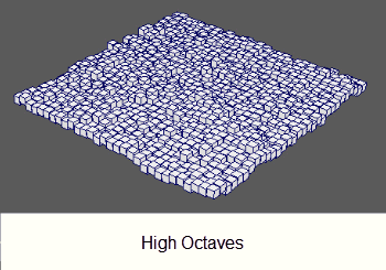

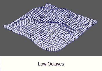

- Octaves
Sets the number of noise octaves. Higher values produce more detailed noise.
- Persistence
- The strength of each noise octave. Higher values make the noise more chaotic.

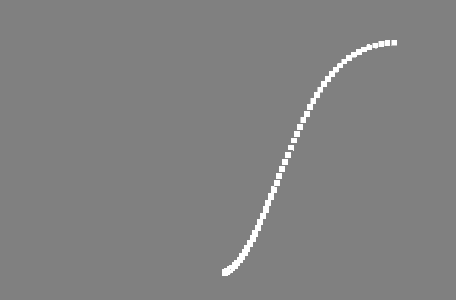

Trigonometry Settings
- X Function, Y Function, Z Function
- The type of trigonometric curve to use along each axis. Only applicable when the Signal Type is set to Trigonometry.

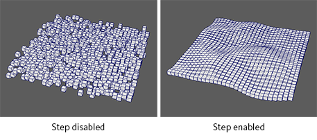

- Enable Step
Offsets each point's noise/trig sample in time by the Step Amount multiplied by the point ID. Enable this to give each point a unique time offset. Disable it to generate more of a turbulence effect.
- Step Amount
The multiplier to apply to each point ID when Step is enabled. Lower values cause all objects to have similar animation, while larger values will cause them to differ greatly.
