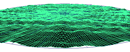

Convert wave displacement to polygons
You can create geometry that represents the wave height by converting the displacement to polygons.
Note:
This procedure works for any geometry with displacement mapping.
To convert wave displacement to polygons
  1. Select the ocean surface.
  2. Select Modify > Convert > Displacement to Polygons. Maya creates a poly plane (oceanPlaneShape_displacement) with the displacement represented by the geometry.
