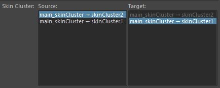

Skin Cluster list
The Skin Cluster list contains a Source and Target column.
The Skin Cluster area lets you control individual skin clusters on geometry that has more than one skin cluster applied.
Click geometry to update the list of skin clusters for the selected geometry, below.
Skin Cluster list
Skin clusters on the selected geometry appear here.
Note: If no skin cluster is selected this list remains empty. Select the geometry to update the list.
The most recently added skin cluster appears at the top of the list.
Source
Select the skin cluster to be copied/mirrored.
Target
The skin cluster to which the copied/mirrored attributes apply.
