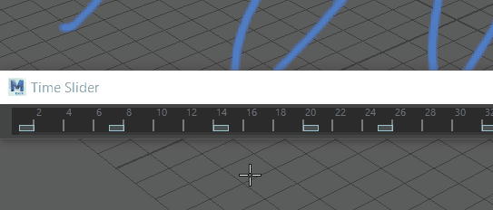

Blue Pencil drawings appear as frames on the
Time Slider, and you can rearrange them.

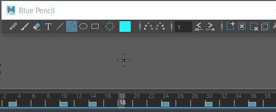

- Add a Blue Pencil frame
- Open the Blue Pencil tool and start drawing in the Viewport: a Blue Pencil frame automatically appears at the position of the Time Slider Current Time Indicator. This frame is considered the Active Blue Pencil frame.
- You can also click
Add Frame
in the Blue Pencil Toolbar, or right-click the Time Slider and select from the Animation Controls menu.
Tip: To add more than one frame at a time, Shift-select a range on the Time Slider, right-click and select . A Blue Pencil frame is created for each frame in the selected range.

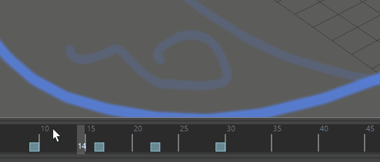

- The difference between Copy Frame(s) and Duplicate Previous Frame
- The
Copy Frame(s) (
) and Duplicate Previous Frame (
) functions on the Blue Pencil Toolbar may sound alike, but they create a different effect:
- Copy Frame(s) lets you copy a frame to the clipboard and paste it anywhere on the Time Slider (provided there is not a frame there already).
- Duplicate Previous Frame creates an identical version of the
previous frame at the current time (provided there is no frame there already). Use
Duplicate Frame when you want an image to persist or repeat throughout a scene.

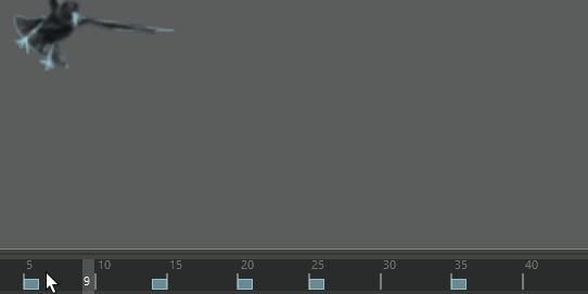

- You can quickly create animation sequences with
Duplicate Previous Frame by copying and transforming sketches along the Time Slider. In the following example, a sketch of a bird duplicated and transformed a few frames apart to create the illusion of flight. See
Modify drawings with Blue Pencil Transform mode.

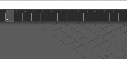

- Move Blue Pencil Frames
- Shift + click to highlight one or more frames on the Time Slider. Once highlighted, drag the selected area to a new location. You can Shift + drag multiple frames.
- You can also use the Retime frame tool to move frames incrementally.
- Scale Blue Pencil Frames
- Shift + click to highlight one or more frames on the Time Slider. Once highlighted, drag the arrows at either end of the highlighted area to grow or shrink the timing between the frames.
