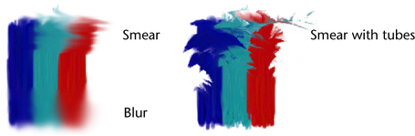

You can smear and blur paint on the canvas using any brush by setting the brush type to Smear or Blur, respectively. Like Erase type brushes, Smear and Blur type brushes use the shape of the brush. For example, if the brush has leaves, the paint smears or blurs where the leaves are painted.
