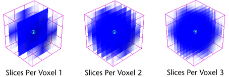

Slices per Voxel
Defines the number of slices displayed per voxel when Maya is in shaded display mode. A slice is a display of values on a single plane. Higher values produce more detail but reduce the speed of the screen draw. The default is 2. The maximum value is 12.
The orientation of the slices is determined by the voxel most aligned with the view plane.

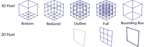

Boundary Draw
Defines how the fluid container displays in 3D views. The grid corresponds with the Resolution settings.
Bottom
The fluid container displays as a bounding box with a detailed grid on the bottom side. For 2D fluids, this setting displays a detailed grid.
Reduced
The fluid container displays as a bounding box, with a detailed grid on the sides furthest away from the camera. For 2D fluids, this setting displays a detailed grid.
Outline
The fluid container displays as a bounding box, with a detailed grid on all six sides. For 2D fluids, a dotted line displayed around the container indicates the potential volume of the 2D fluid. Note that 2D fluids have thickness, and render as a volume, not as a flat planar surface. To render a fluid as a flat surface, you must map a 2D fluid texture to a plane.
Full
The fluid container displays as a bounding box, with full grid lines representing each voxel. For 2D fluids, this setting displays a detailed grid.
Bounding box
The fluid container displays as a bounding box only.
None
The fluid container does not display, however, any visible properties do display.

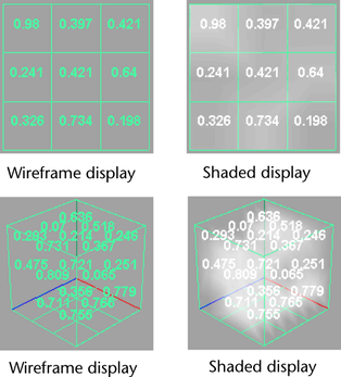

Numeric Display
Displays numeric values for the selected property (Density, Temperature, or Fuel) in each voxel of a Static or Dynamic Grid. The numbers that display represent the values before the Scale is applied. For example, if the Density value in a voxel is 0.2 and the DensityScale is 0.5, the number that displays in the voxel is 0.2, not 0.1. No numeric values display when this option is set to Off or when the Contents Method for the selected property is set to Gradient.
Numeric Display can be used in both shaded and wireframe display modes.

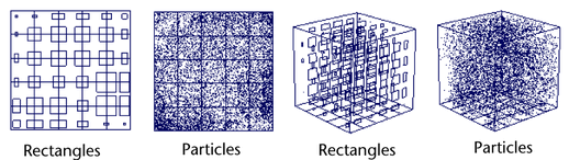

Wireframe Display
If the Contents Method is set to Gradient for the property selected for Shaded Display, this option defines how to represent the opacity of the property when Maya is in wireframe display mode.
If Contents Method is set to Static or Dynamic Grid for the property selected for Shaded Display, this option defines how to represent the values of the property when Maya is in wireframe display mode.
Off
Displays nothing in the fluid container.
Rectangles
Displays rectangles on the grid lines of the fluid container. Larger rectangles represent areas with higher values or opacity.
Particles
Displays particles to represent values or opacity. Areas with denser particles represent areas with higher values or opacity.
