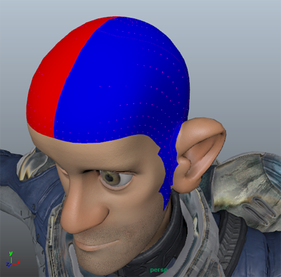

  6. In the Color section of the Tool Settings window, click the color swatch and select blue.
    Maya automatically sets the other 3D Paint Tool settings for region map painting.
  7. Use the 3D Paint Tool to paint half of the scalp area blue.
    Note: It is important that one side of the scalp is red and the other side blue. Make sure there are no patches mistakenly painted blue in the red half of the scalp. Otherwise, the region map will not work properly.
  8. Click this icon to save the Ptex map.

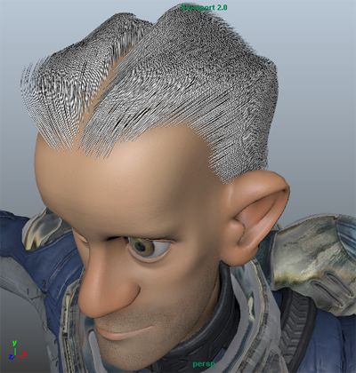

  9. In the Region Control section, set Region Mask to 1.0.
    Setting the Region Mask attribute to 1.0 enables the Region Map on the mesh.

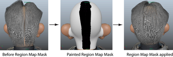

    After creating the hair part, you may need to create a Region Mask to override the part along the back of the head. This way, the part starts at the front hairline and stops at the crown of the head.
  10. Preview the Description.
    After creating the hair part, you may need to create a Region Mask to override the part along the back of the head. This way, the part starts at the front hairline and stops at the crown of the head. To do this, use the same technique as creating a hairline (see Create hairlines and bald spots using Ptex maps).
