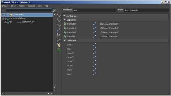

The Asset Editor allows you to manage all the assets in your scene from a single window. It consists of two panels.
Similar to the Outliner, the left panel displays a list of all the assets in your scene and their attributes. From this panel, you can
- View and arrange your assets
- Publish and unpublish attributes
- Select specific assets to edit
The right panel displays template binding information for the asset selected in the left panel. From the right panel you can
- Bind and unbind published attributes to the published names from a template
- Publish or unpublish unbound attributes
- Rename published attributes
You can use the Asset Editor to manage the binding between published names and internal node attributes. The Asset Editor is also the main interface for managing the templates in your scene. Aside from these two functions, you can also publish/unpublish attributes, add and remove nodes from assets, create Views and Binding Sets, and perform any other asset-related operations.
The Asset Editor has two modes of operation. In Select Asset mode, you can quickly traverse from asset to asset and show individual asset’s node contents and attributes.
In Pinned Asset mode, you can publish or unpublish attributes in the left panel and bind and unbind attributes in the right panel. You can also create Views and Binding Sets.
You can switch between these modes by selecting an asset and clicking the Pin Asset icon
In the left panel, a selected attribute appears highlighted and. In the right panel, a selected attribute appears with an arrow icon.
