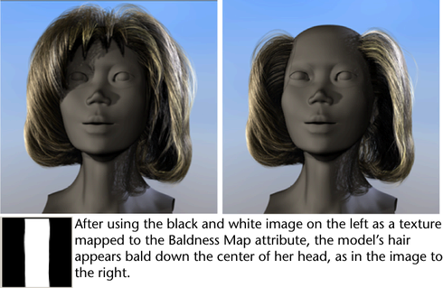

Baldness Map
Reduces the hair density using a texture. The texture used must be a 2D texture.

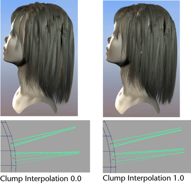

Clump Interpolation
This value specifies the amount of interpolation between the hair clumps of your current hair system. For each hair clump, Clump Interpolation evaluates its three closest neighbors and does the following:
  • Spreads out the ends of the hairs in your hair clumps, moving the tips of the hairs towards the other hair clumps.
  • Angles the hairs in the hair clumps towards the other hair clumps, away from their faces’ normals.
The higher the Clump Interpolation value, the more distributed the hairs in your hair clumps appear. This is useful when you want to create a smooth continuous head of hair with less obvious clumping.
This attribute has an overall effect on all the hair clumps of your current hair system. The effects of this attribute are more apparent with higher Clump Widths than with lower Clump Widths. Clump Interpolation is 0.0 by default.
Important: When Clump Interpolation in greater than 0.0, the hairs in your hair clumps may not lie within their clump boundaries.
This can cause undesirable hair collisions as collisions only occur within the original hair clump boundaries, not in the regions of clump interpolation.

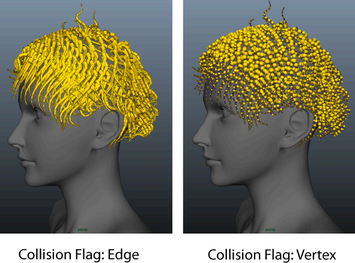

Collision Flag
Specifies which nHair object's components participate in collisions.
Vertex
The nHair object’s vertices collide. Collisions occur at the collision spheres that surround nHair vertices.
Edge
The nHair object’s edges collide. Collisions occur at the collision cylinders that surround nHair edges.

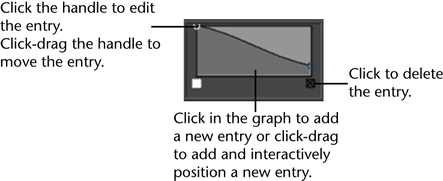

Stiffness Scale affects the overall stiffness from root to tip of the hair. The left of the graph is the root and the right is the tip. Typically the root of a hair is thicker and therefore stiffer than the tip. This attribute multiplies a combination of the Bend Resistance and Twist Resistance attribute values.

The Attraction Scale ramp attenuates the Start Curve Attract attribute value along the length of the hair clumps in your hair system.
You can use the ramp graph to define a varied stiffness from root to tip for the hair clumps in your hair system. The left-side of the ramp graph represents the roots of the hair clumps in your hair system and the right-side represents the tips. For example, if you want the roots of your hair clumps to be less stiff than their tips, then the value on the right-side of the ramp graph should be smaller than the value on the leftside.
The Attraction Scale ramp values are multipliers of the Start Curve Attract attribute value on the hair system. So an Attraction Scale of 1.0 does not affect the Start Curve Attract, and a Start Curve Attract of 0.0 is not effected by Attraction Scale.

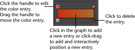

Interpolation
Defines the mathematical method used to smooth the values of the current hair system’s hair curves. Ramp Interpolation controls the way the intermediate values are calculated.
None
No interpolation is done; the different colors just show up as different bands in the final texture.
Linear
The values are interpolated linearly in RGB color space.
Smooth
The values are interpolated along a bell curve, so that each color on the ramp dominates the region around it, then blends quickly to the next color.
Spline
The values are interpolated with a spline curve, taking neighboring indices into account for greater smoothness.

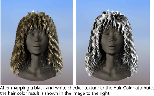

The base color for hairs. The final color used is determined after the Hair Color Scale and randomization parameters are applied. Also individual hair clumps may override the Hair Color.
Use the Hair Color map button next to this attribute to map a texture to the hair color to create different hair shading looks. The following image uses a black and white checker texture mapped to the Hair Color attribute.
Hair Color Scale
Hair Color defines the global color of the hairs from root to tip. The left of the graph is the root and the right is the tip.
Advanced ramp features exist. For more information, see Applying textures to a ramp.
