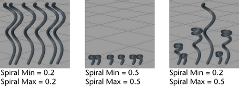

Spiral Min, Spiral Max
Defines the minimum and maximum amount of spiraling that occurs around the stroke normal. Paint Effects randomly chooses values within this range for newly created tubes.

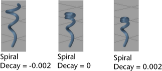

Spiral Decay
Defines how the amount of spiraling (tightness) decays from the beginning to the end of a tube. If the value is 0, the spiral is constant. Values greater than 0 produce tighter spirals, Values less than 0 produce looser spirals.
