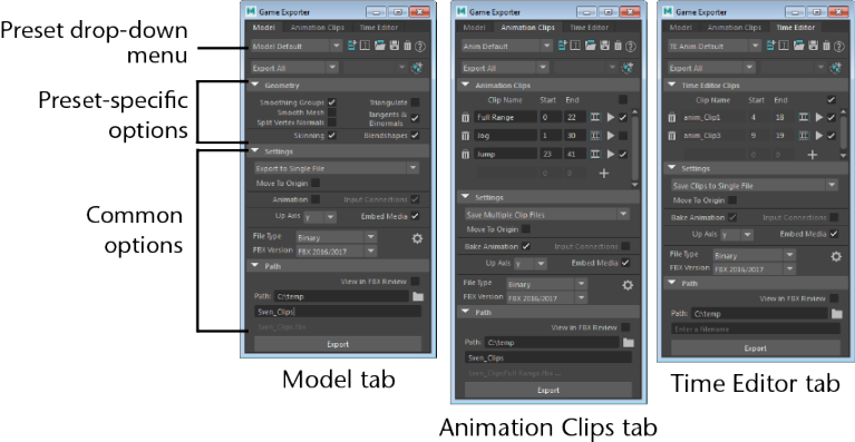

- Select File > Game Exporter from the main menu
The Game Exporter provides a streamlined FBX export workflow for sending models and animation clips to your game engine. Each tab exposes a minimal set of FBX options, letting you export assets without needing to understand or change too many settings. The exposed options in each tab are saved as a preset that you can reuse when exporting from other scenes.

| To... | Do this |
Switch between sets of export options. |
Open the first drop-down menu and select the Anim Default preset, the Model Default preset, or any custom preset you have added. ![]() The rest of the options in the window update dynamically. |

Tool Settings
Most of the options that display in the Game Exporter can change depending on the preset you select. By default, the Anim Default preset is set up for standard export of animation clips, and the Model Default preset is set up for standard export of static meshes.
For information on creating your own preset with additional or different FBX options, see Create a Game Exporter preset.

Animation Clips settings (Animation Clips tab)
This section lets you define multiple clips of animation within the scene in order to export them either as separate files, or as separate takes in a single FBX file. You can create, name, set the start and end frames, and playback the clips in this area. See Export animation clips with Game Exporter.
Once you have a list of clips created, use the check boxes on the right to select which clips to export with the current operation.
Geometry settings (Model tab)
- Smoothing Groups
Converts edge hardness/softness to Smoothing Groups for the exported geometry. When off, only explicit normals are exported with the file.
- Smooth Mesh
