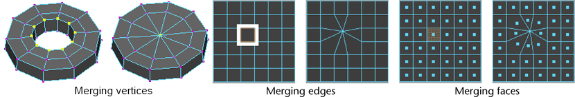

You can merge pre-selected vertices using the Edit Mesh > Merge and Edit Mesh > Merge to Center commands. The former is useful for combining components that are very close or overlapping (like when merging a polygon mesh to a mirrored copy) while the latter is useful for filling holes or creating points.

To merge edges or faces into a single vertex
  1. Select the vertices, or the edges or faces bordering the vertices that you want to merge to a center point.
    Note: You can only merge edges that are part of the same polygon mesh. If you want to merge edges from different mesh objects, you must first combine (Mesh > Combine) them.
  2. From the main menu bar, select Edit Mesh > Merge to Center.
