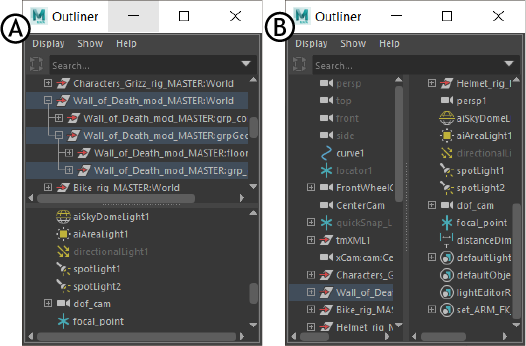

Window Layout
Outliner split views A. Horizontal, B. Vertical
Lets you choose the way the Main Maya Outliner (Windows > Outliner) contents are shown. Expand this rollout to choose between Split Horizontally (the default) or Split Vertically.
Note: The option to split the Outliner vertically is available only in the main Maya Outliner (Windows > Outliner). Other outliners, such as the Graph Editor outliner or the Dope Sheet outliner, can only be split horizontally.
