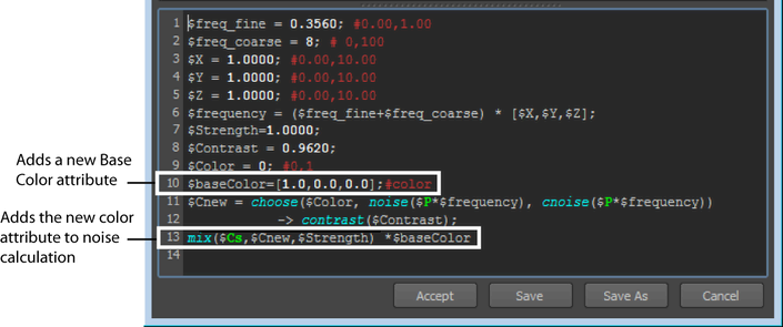

  5. In the text field of the XGen Expression Editor, do the following:
    • At line 10, type:
      $baseColor=[1.0,0.0,0.0]; #color
      This specifies that the root_color parameter is now used as the Base Color attribute for the expression.
    • At line 13 after mix($Cs,$Cnew,$Strength), type * $baseColor.
      This adds the Base Color value to the noise calculations.
  6. Click the swatch in the XGen Expression Editor to validate the expression.
  7. (Optional) In the Customer Shader Parameters section of the Attribute Editor, use the sliders in the editor to modify the noise pattern in the expression.
    For example, set freq_fine to 0.356 and freq_coarse to 8.
  8. Click Accept.
