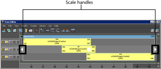

To scale multiple nCache clips at a time
- In the scene view, select the object whose cache clips you want to scale.
- In the Trax Editor, select List > Load Selected Characters.
All the current object’s caches appear as clips in the track view.
-select the nCache clips you want to scale. The cache clip scale handles appears.
- Drag the scale handles to the left or right to scale all the selected nCache clips at the same time.

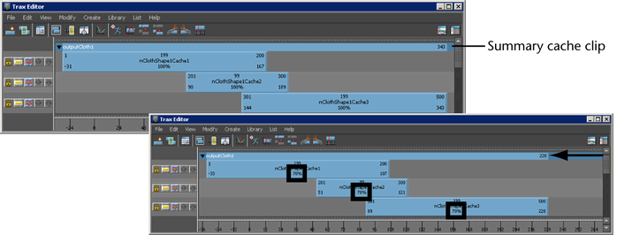

To scale all of an object's cache clips
- Drag the left or right sides of the summary cache clip to scale all the selected object’s cache clips.
