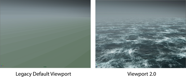

Viewport 2.0 replaces the legacy viewports (default and high quality), and provides improved performance, letting you view high-quality lighting and shadows, materials, and other effects directly within the Maya viewport, without the need to render.

- Pre-render visualization
- Support for complex shading networks, displacements, normal and bump mapping, light shadows, per-pixel lighting, and ambient occlusion, provide a better realtime idea of what your rendered images will look like.

Differences between Viewport 2.0 and the Legacy default Viewport
- Objects with no shader
- In Viewport 2.0, objects with no shader assigned appear in the scene view shaded green. If a shading network error occurs, the object displays white in the scene view. If the object is an OpenSubdiv object, it displays as white dots. This visual change alerts you of any missing shaders.
- In the legacy viewport, objects with no shader appeared as a wireframe.
