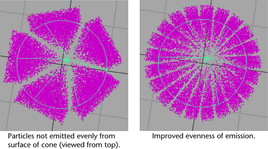

You can spread the emission more evenly from NURBS surface emitters. This is often beneficial for surfaces that have sharp curves or bends.
To spread emission more evenly
- Select the emitting NURBS surface.
- Display the Attribute Editor.
- Click the geoConnector tab. Expand the width of the Attribute Editor if you don’t see the tab.
- Increase the value of the Tessellation Factor, then rewind and play the animation.
The default value is 200. Try doubling the value as many times as necessary to get the desired evenness. Higher values increase processing time. If you add two or more surface emitters to an object, each uses the same Tessellation Factor.
