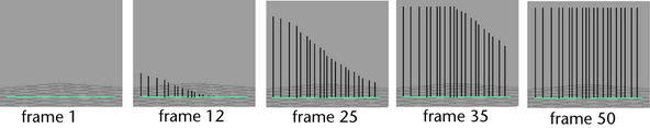

This option has no effect unless Time Clip is on. Turn on Stroke Time to animate tube growth and flow from the beginning of the growth simulation to the end of the growth simulation.
Time Clip
Turn on Time Clip so that animated tubes first appear and begin to flow at the time set by Start Time (seconds), and die at the time set by End Time (seconds).
If Time Clip is on, but Stroke Time isn’t, tubes along the stroke path are already planted, which means the tube growth is uniform.
If Time Clip is off, the tubes display at the end of their lifespan along the stroke, the growth simulation having completed. In this case, only gap, twist, or texture flow are animated.
