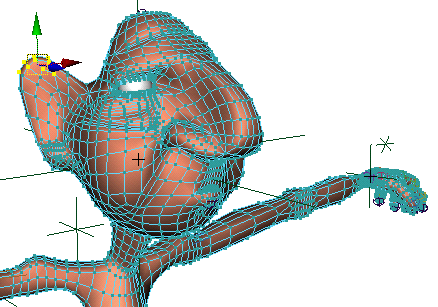

Point tweaking skin objects refers to moving or setting keys on the individual skin points of a skinned object. When you tweak the points of a skinned object, Maya automatically prevents the unexpected effects that can occur when you manipulate the object. Maya does so by applying the tweaks to the object before applying any deformations to the object.
When you bind skin, Maya creates tweak nodes as well as nodes for the skinned objects. In the dependency graph, Maya places the tweak nodes as inputs for the smooth skin objects so that any point tweaking is carried out before the evaluation of the skin nodes. This placement means that, by default, a skinned object’s deformation order includes point tweaking first.
