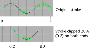

Modify stroke end bounds
You can reveal a segment of a stroke by “clipping” the stroke end bounds in the End Bounds section of the strokeShape Attribute Editor. Only the portion of the stroke within the range defined by the Min Clip and Max Clip values displays. You can use these options to animate the stroke (for example, a trickle of water, a burning fuse, a vine growing over an object).
Min Clip—Specify the point along the stroke that defines the beginning of the stroke segment. When the Min Clip value is 0, the beginning of the stroke is not clipped.
Max Clip—Specify the point along the stroke that defines the end of the stroke segment. When the Max Clip value is 1, the end of the stroke is not clipped.
