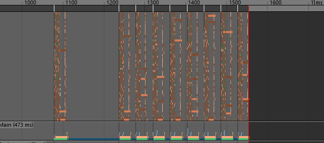

The Profiler lets you locate performance bottlenecks in your scene by recording and demonstrating in a graph the amount of time that each process consumes.
You can determine when to start and stop recording. You can also save your recording as a text file and reload it in the draw region at a later date. You can perform these tasks via the Profiler window or via the profiler MEL/Python command.
Graph your events in one of the following ways:
  • Category view: displays the activities for different categories such as XGen, Bifrost and Qt. This is the default view.
  • CPU view: displays the activities of each of your processors. Select this view to better evaluate multi-threading.
    Note: CPU view is unavailable on Mac OSX.
  • Thread view: displays the activities of each of your threads. Select this view to evaluate all the activity on a single thread.
For more information on how to record a process and how to work with and interpret your graph, see Profile a scene to improve performance .

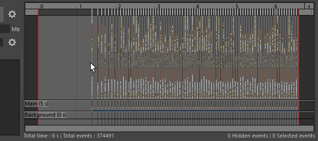

Record a process
Click to streamline recording categories.
Play your animation, then click Start Recording. When the buffer is full, recording stops.
You can also click Stop Recording.
Ctrl + R toggles recording on and off.

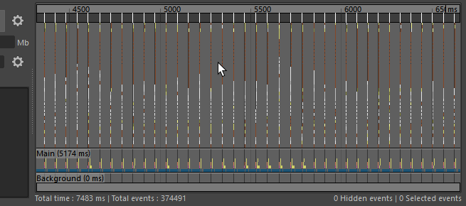

Navigate in the draw region
Shift + Alt + right-drag up/down to zoom vertically.
Shift + Alt + right-drag left/right to zoom horizontally.
