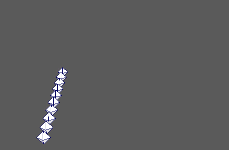

Duplicates the MASH network and allows you to perform transformations on the replicants.
Replicator
- Replicants
- Determines the number of times your MASH network will be duplicated.
- Transformation Space
- Offset Position X, Offset Position Y, Offset Position Z
- Determines the spacing between replicants.
- Position Ramp
- Customizes replicant positions using a ramp.
- Scale Together
- Scales all points together from the axis.
- Scale Replicants X, Scale Replicants Y, Scale Replicants Z
- Scale the space between replicants.
- Scale Ramp
- Customize the shape of the scale using a ramp.
- Rotate Together
- Rotates all points together from the axis or driven rotations.
- Rotate Replicants X, Rotate Replicants Y, Rotate Replicants Z
- Rotate the replicants around a shared center.
- Rotation Ramp
- Customize the shape of the rotation using a ramp.
- Rotate Around
- Sets the point around which replicants will rotate.
- Offset
- Offset the number of replicants. The effect resembles what would happen if additional invisible replicants were added before the actual replicants.
- Step ID
- Increments IDs with each replicant, rather than with each object.
