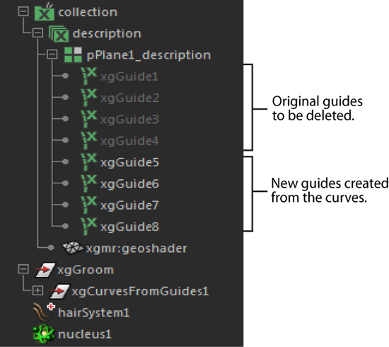

    Maya converts the dynamic curves to new guides and hides the original guides. The new guides inherit the curves dynamic properties.
  11. In the Outliner, select the hidden guides and delete them.
